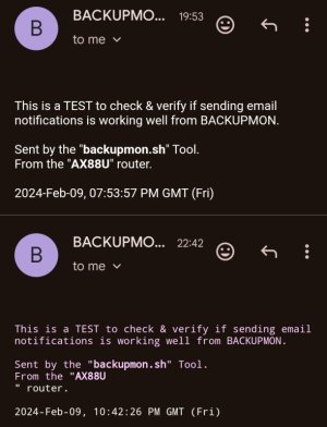

Why the different font and colours in the new version? Also see a broken line.
Top the test from earlier, below the new test email:
Never mind. That only affects test emails. Success/failure emails are well formatted.

Yeah I noticed that too... I need to figure out why it does it differently between the two. ;) As long as you get emails, that's what counts! Lol

WRT the "broken line" in the email:
From the "A88U
" router.
It's very odd. It looks as if a linefeed was inserted just after the value of the "FRIENDLY_ROUTER_NAME" variable (which is the one used in that line), but I just double-checked the script and I don't see any LF at all between the var and the double quotes. Intriguing!!

I wouldn't worry too much. After all, it only affects test emails (for me).

Thanks for looking into this @Martinski ... you never know, my editor can do some weird things. ;) I'll see if I can get around this... maybe instead of breaking lines, just make lines continuous text, and end each one with a \n will get around it.
EDIT: @Martinski... that was the problem... when you eliminate that run-on printf statement, then the formatting works fine. The messages in these emails is short enough... I don't think I need to worry about needing to printf paragraphs. ;)

... I'll see if I can get around this... maybe instead of breaking lines, just make lines continuous text, and end each one with a \n will get around it.
EDIT: @Martinski... that was the problem... when you eliminate that run-on printf statement, then the formatting works fine...
Sorry, I don't quite understand what you're trying to say. The section of the email with the line "From the ... router" is generated in a different/separate function from where the body of the email with the TEST message is set, so I'm not seeing how the latter could affect the former WRT breaking the line in two. But no worries, I'll take a look at the related code changes when you publish them in your GitHub repository to see what you meant exactly. I'm just curious & would like to understand what the cause is/was.

Typically, headers like these are added by outbound email server, and they are only displayed if specifically configured in email client.
Is this repeatable for you every time you send, or receive a regular "success/failure" email? Does this same thing happen when you test it from AMTM directly? I am sending from google to google... and I'm not seeing this extra base64 "UI-OutboundReport" header info.
I will run some additional tests and let you know..
Here are two examples. Test mail from amtm is just fine. Backupmon again creates a verbose email.

The code is literally this...
    printf "Date/Time: $(date +'%b %d %Y %X')\n"
    printf "Asus Router Model: ${ROUTERMODEL}\n"
    printf "Firmware/Build Number: ${FWBUILD}\n"
    printf "EXT USB Drive Label Name: ${EXTLABEL}\n"
    printf "\n"
    printf "SUCCESS: BACKUPMON completed a successful primary backup to destination: ${BACKUPMEDIA}."
    printf "\n"
    } > "$tmpEMailBodyFile"
For some reason it's inserting this block of garbage in the middle of all this. Perhaps it doesn't like blank printf "\n" lines? Let me try a different variation, and see if that sticks...
