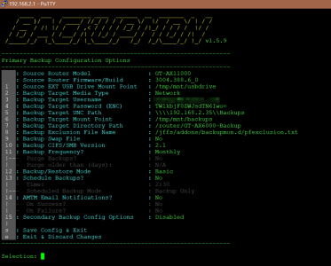

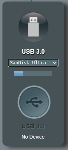

Here is the config. I have only usb 3 flash drive. I did not touch with usb setting think it auto config with the correct usb drive.
I have a feeling it might be using some default name... try hitting the "1" option under the config, and let it choose the correct name... then save your settings.
Item #7 in the settings look like the default setting. Are you sure this is correct for your server?
Yeah.....When I thought about it, I did not run through the setting. But the default setting looks correct, so I didn't go each step. It's oversight. Will report back if I could get it running or not.
You also need to check if #5 is correct. Normally a share on a (Linux) samba server would not use capital letters in the share name (IIRC)
You definitely need to step through these one by one... many of these are just sample default entries to show correct syntax. Once you go into each item, it will explain what it needs so that you pick what is right for your particular environment.
