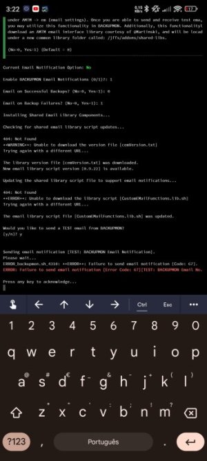

Now things are getting wierd. This time a sceduled backup created the same error. Yet this morning I got the emails?????

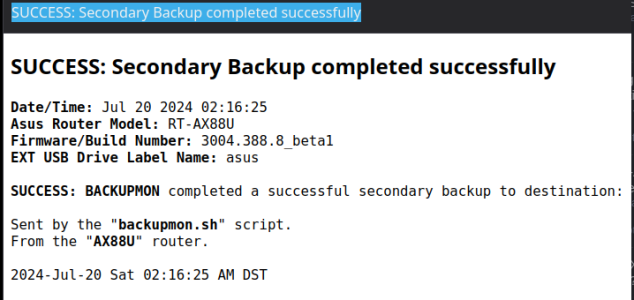

Thanks for the bug report... guess I should turn on success emails so I would have seen this. BAH. Working on it...
I got the same error message when running a manual backup and when my backup ran overnight no notification was received.
I'm getting errors no matter what I try... the only time it doesn't error out is when you initially set up email functionality under config option #14, and select Y to send a test email.

OK for reals this time... should be fixed and ready to rock! Sorry for the inconvenience, everyone! Let me know if you see successful emails from this point forward. ;)

Email works again... WHOOOO!

Confirmed that it fixed email success messages for me!
