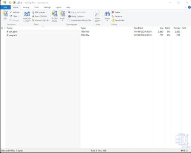

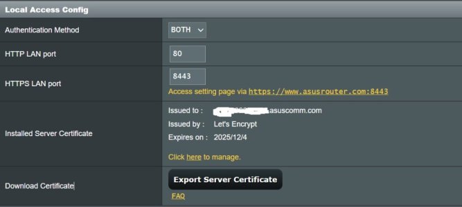

I cant seem to get the certificate, under Administration>System>Local access Config to export to a .cert file, it exports as "cert_key" zip file and when extracted there are 2 files "cert.pem and key.pem"
what do i need to do here, i have no idea what these files are and righ clicking has no option to instal...

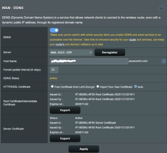

My set up is in the sceen grabs below.

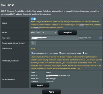

I don't what the fix is but a have workaround I been using in that scenario .
Go to the wan/ddns page.
In the http/ssl certificate section - select auto and apply.
Then select free cert from Let's Encrypt and then apply.
Usually I'm good till the next reboot.

Thanks, ill give that a try tomorrow and report back
So this seems to work, though im not sure how i managed it, seems to want the certificate, which is now exportable after setting to auto and exports a "cacert_key" zip file with "cakey.pem and cert.crt" files inside, I used this cert.crt file.
So HTTPS seems ok, HTTP still "Not Secure"
