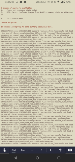

I have diversion working and mails sending correctly, however when I try to activate email sending in vnstats, it throws this error...
See above posts with @Jack Yaz and me, a fix it's coming in an Vnstat update.
Edit: Actually, this is somewhat a different problem than I originally thought I saw in your screenshot. Sorry mate.

The only issue I have is option 2. Toggle emails for daily summary stats. Shows currently DISABLED. When I choose option 2 HTML it actually sends the email just fine however the following messages are generated AND option 2. Toggle emails for daily summary stats. remains DISABLED.
dn-vnstat: Attempting to send summary statistic email
dn-vnstat: Summary statistic email failed to send
ps - this is easily fixed as per thelonelycoder post #39 - sorry for not reading that post.
Try switching to develop branch, you might have a broken entware version of openssl. I'd love to know what you do to your setup because you always have weird problems!

I switched to your dev branch, same occurs.
However the email is sent just fine, despite the errors

Then you have something very broken with OpenSSL by the looks of it.
