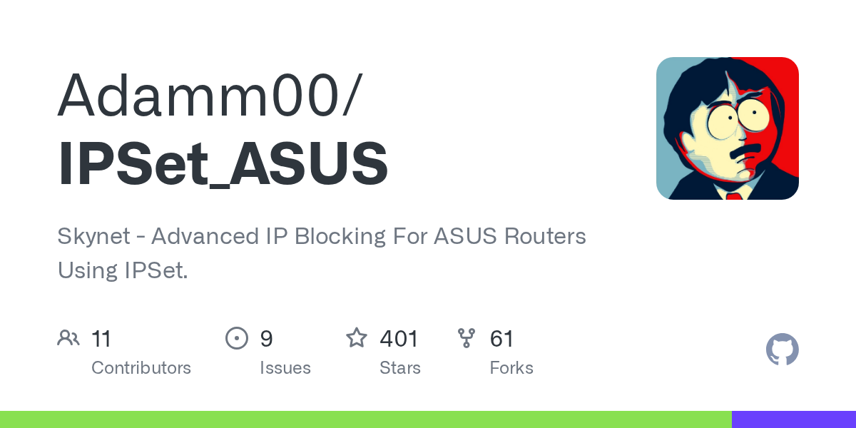

It works correctly upon Install however what I mean is that over time you will need to whitelist some websites/hosts as on occasion there are false positives. (you may find some websites not working and will have to debug to discover if this is a skynet block) - There is a correct way of doing this as detailed Here however when I do it I tend to disable skynet in putty, see if the website works when it's off, if it does I know it's skynet, if it doesn't I start looking elsewhere (adguard etc) If it is skynet I then use the whitelist command to whitelist it.

You can also pick and choose which ban lists you use and/or add as per the github link above. Personally I just use the defaults, but some of the guys on the forum are really into it and use all kinds of custom lists.
