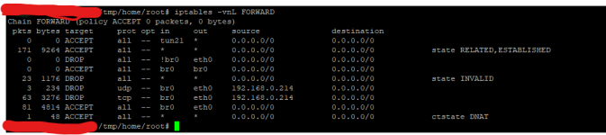

So the progress is that I managed to get the IPTABLES command to work (Yes, capitals for emphasis). I now have a table that looks like the attached. . . . .and I can SSH into the "device I do not trust" on IP 192.168.0.214. (I am hotspotting a computer, and then Puttying using my router WAN address, and an external port which I am forwarding to the SSH port on the device.)
I am going to do some methodical experimenation again later. . .involving rebooting the *&$#& router often, rather than just applying changes. Something is definately not right here.

Use whatever method works for you. I figured if you could get Network Services Filter working, it would make things easier. I know that dealing w/ the router via ssh, iptables, etc., is a major hassle on the OEM firmware. But if you can make it work for you, that's fine.
