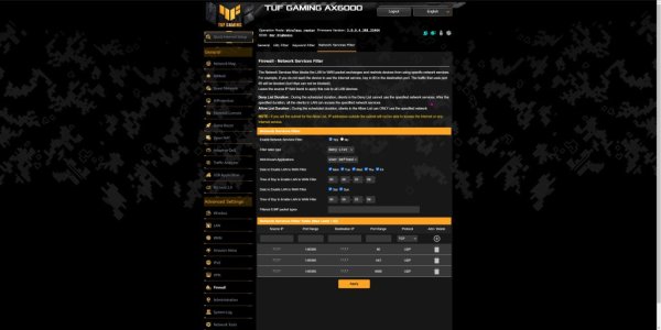

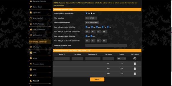

WHAT am I doing wrong ?. PLEASE SEE ATTACHED SCREENSHOT of what I hoped would block QUIC. on both main router and the 1 Node (note I am using main router and still showing QUIC)

Below is the screenshot of THE way I expected would block QUIC ?. That is Network Services Filter but maybe somehow they avoid it ??
