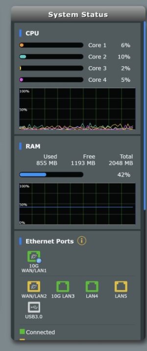

I've only been on the 3.0.0.6.102_36801, for less than 24hrs - but so far the network feels more stable (all my tests are positive), CPU seems to have a better spread across all 4, vs core 1 under prior firmware, while the RAM a little more but more stable. The GUI feels more responsive and the built in speed test is now accurately measuring connection speed - which it was not under the previous firmware.

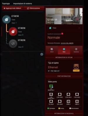

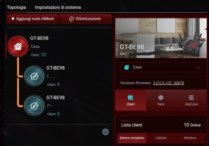

I bought 3x Be98 and unfortunately they all seem to have the same recognition problem, I must also say that the connection works at maximum if it were not for the yellow selection and the 10/100 writing. I therefore believe that it is not a hardware problem, but rather a software aspect that hopefully will be resolved with a new firmware
That would be very interesting if this was a SW issue. Do you have the ability to perform a Speed test from a client ? maybe such as iperf ? when i had the issue my throughput was being limited (what im saying is it wasn't just a GUI display problem) the connection was really a 10/100

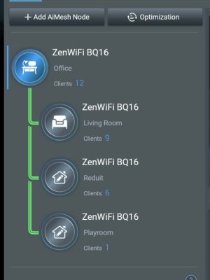

Quick Update: 2nd set of BQ16 arrived and are now plugged in so now 4 in total + 2 QNAP and 1 EAP as AP's.
Yes, I have performed various speed tests and the connection always works normally 10Gbs RX and 2Gbps TX as per my ISP (on all two nodes).
I have reported the matter to Asus and I am waiting for a response. Obviously I have also performed close tests with various types of cables from cat6, cat7 and cat8. In my opinion it is a problem of recognition via SW that on BQ16 does not occur while on BE98 it does. The usual luck. :(

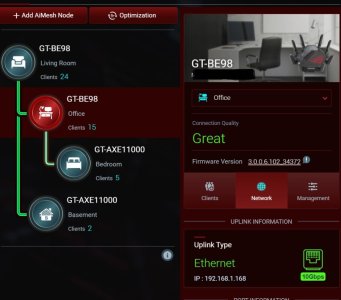

I have the same issue wit 2 gt-be98
the only way it is working is with firmware 34372.
Upgrading the firmware shows the uplink connection to 10/100 but the speeds are indeed 10gbps. So I think it is a visual bug.
The other issue that I have when upgrading the firmware is 6ghz band not beeing broadcasted to the other 2 nodes that I have (2 axe11000) and the router that is connected wireslly to the mesh is beeing bounced between main router and the other one (i specified the connection to be with the 2nd router in mesh)
With 34372 firmware is working great.

I can confirm the attached beta firmware 9.0.0.6.102_37292-gf7faace_1032-g90bf2_BB0B fixed the issue with the wired backhaul showing as 10/100Mb when connecting 2 GT-BE98 routers in AiMesh over a 10Gb connection
