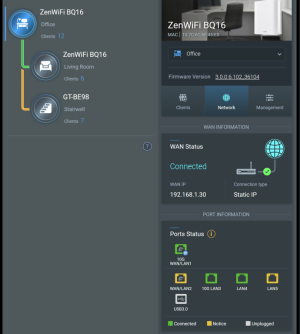

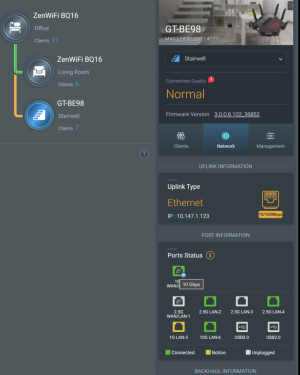

Yes, over the 10G see the second screen shot, it shows 10G but says the uplink is 10/100
It looks like it’s using the lan 5 port as the uplink. Did you verify what port its using for the uplink?
That was the only port showing 100MB, I just unplugged that device and changed to port 3, 100MB moves with it, device plugged is just an Ethernet to RS32 convertor to a Monoprice (music amp). Im getting closer....
It feels like the GT-BE98 or the BQ16 believes that to be the Uplink (which it is not) do you know if it locks in a MAC or IP ? somewhere? can that be changed in config somewhere ?

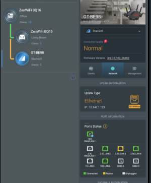

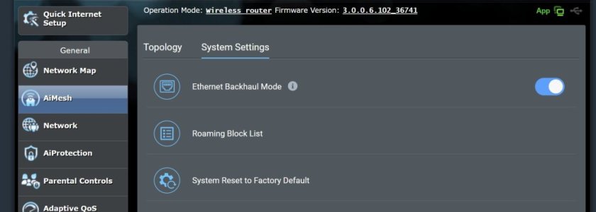

Do you have ethernet backhaul mode enabled on the router?
Yes, ethernet backhaul is enabled

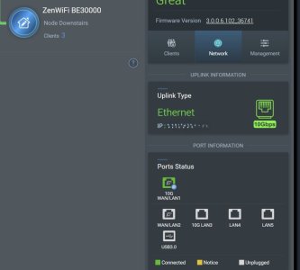

Please post a pic of your GT-BE98 (imesh GT-BE98), it should look similar to the one below.
which is this

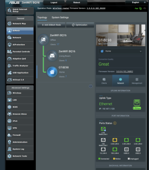

Ok. Unplug all the ethernet cables from the GT-BE98. Get the newest cat 6 ethernet cable you have and ensure to plug it into the WAN 10G port on the GT-BE98, do not plug in any other ethernet for now. After you're finished with that post 2 pics GT-BE98, one with the management tab and the other with the network tab.
Here you go - as requested. as you can see the 10G is lit up but it still goes to 10/100
Yep, that’s weird. The only other thing I can recommend is resetting the GT-BE98 and then set it up as a node. Hopefully that will fix the issue. Do you know how to reset it?

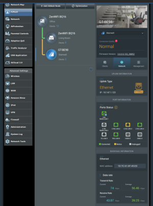

Ive spoken to Asus support, looks like it might be a defective 10GB Port on the BT98, i currently have it running over the 2.5GB (and that is working fine) but the reason i bought these was for thew 10GB backbone - they have given me a contact to request a replacement device as it is under warranty.
Ill repot back once i get a new device - just to update and confirm that 10GB, but it looks like I was the only one having this specific issue, id say its safe to combine the BQ16 and BT98.
