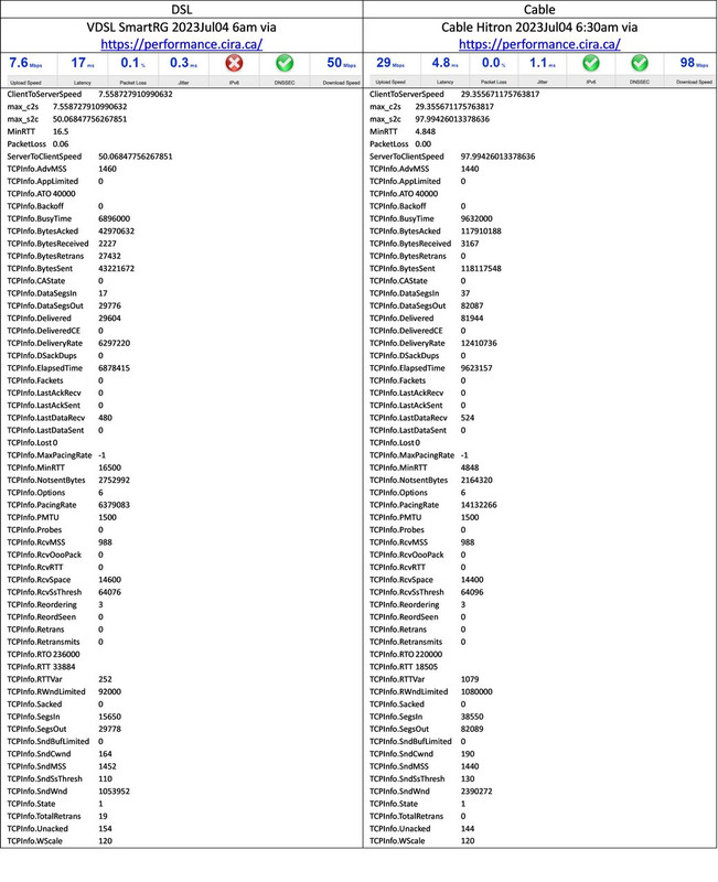

So while my Cable Down/Up speeds are per spec, why is IPTV, even still images, better & of more consistent quality on my 50M VDSL than my 100M Cable? The quality of my cable IPTV seems to fluctuate up&down while I'm watching whereas VDSL is better & more consistent.
I'm running IPTV via the Teksavvy TekTV app. I can run on both Firestick 4K & Chromecast for Google TV.
Here's my cable modem/router HITRON CODA-4680 stats (note: the installers have already put in a brand new thicker cable to improve my stats)
Here's a detailed VDSL (SmartRG SR516AC) vs Cable (HITRON CODA-4680) stats comparison. (collection done while ethernet connected, 7am with no other inhouse activity)
https://i.postimg.cc/J7SL6X39/VDSL-vs-Cable-compare.jpg
Do the router & comparison stats give any hints on why the cable IPTV isn't as good as the VDSL? If there, can these issues be fixed?
I understand VDSL is a a pseudo direct connection whereas cable is a shared service .. but i have to believe one can get better cable IPTV than i'm currently getting.
All ideas, considerations welcome .. Thanks in advance.
Looks like the MTU on your cable is lower so you should get that set correctly in the Asus to prevent fragmentation. But other than that the stats on your cable connection look better. But who knows, maybe they have a worse route to the IPTV provider via cable. The ISP is the same for both?

hi drinkingbird ..
re: Looks like the MTU on your cable is lower
the only MTU'ish variable i see in my VDSL-to-Cable comparison is the TCPinfo.PMTU variable & it's showing 1500 for both my VDSL & Cable .. what am i missing?
yes, Teksavvy is my ISP for both my VDSL & Cable .. BUT .. Teksavvy is a TPIA so the last mile for VDSL is Bell & the last mile for Cable is Rogers.

The reported MSS of 1440 vs 1460 is a clue that your MTU on cable is lower.
In theory it should work fine with fragmentation but it is one thing to check.
My guess is it is something in their router. Can you run it in bridge (modem) mode and use your Asus only? Or replace it outright with a plain modem?

hi drinkingbird ..
I flipped the cable modem/router into Bridge mode (ie. disable Residential Gateway Function) .. no material difference in IPTV/image quality.

Well either their network is having varying performance/packet loss issues or for some reason the cable route to your IPTV provider is more congested/problematic than the DSL route.
The test you did makes it look like the cable is better but that is only to the test server, the IPTV provider could be totally different. You could try running a ping to the IPTV server for like 30 mins and see if there are drops or latency fluctuations etc.
