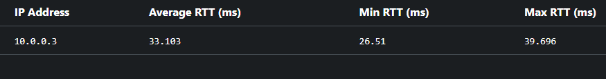

The router at home is an AX-86U running 3004.388.10.12. I have set up a VPS running a wireguard server. I have tried a couple of setups and I cannot access my lan network from remotely. I can only access the router's wireguard ip address.

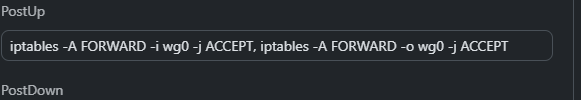

On the server I have set ip forward =1, I have tried allowed ips as 0s as well as the home network ip on both the server and my remote devices with the Asus as both 0's and the server's ip. I have tried blank iptables and several other options seen from various setups found on the internet.
