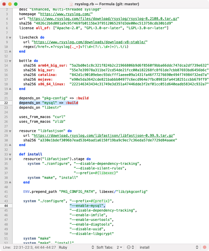

Modify the formula for rsyslog to enable storing logs to a mysql dabase:
brew edit rsyslog
Then add the highlighted line to the file (line 22 and line 44)
xlsyFb+
Then build rsyslog from source by running
brew install --build-from-source rsyslog

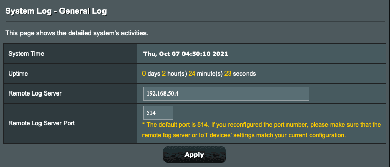

Configure ASUS router
First, assign a static IP address to the host running rsyslog.
Then go to "System Log", and fill in "Remote Log Server" with the static IP address from the previous step, and fill in "Remote Log Server Port" with "514".
Hit "Apply". This will have all AiMesh nodes send their logs to the logging server.

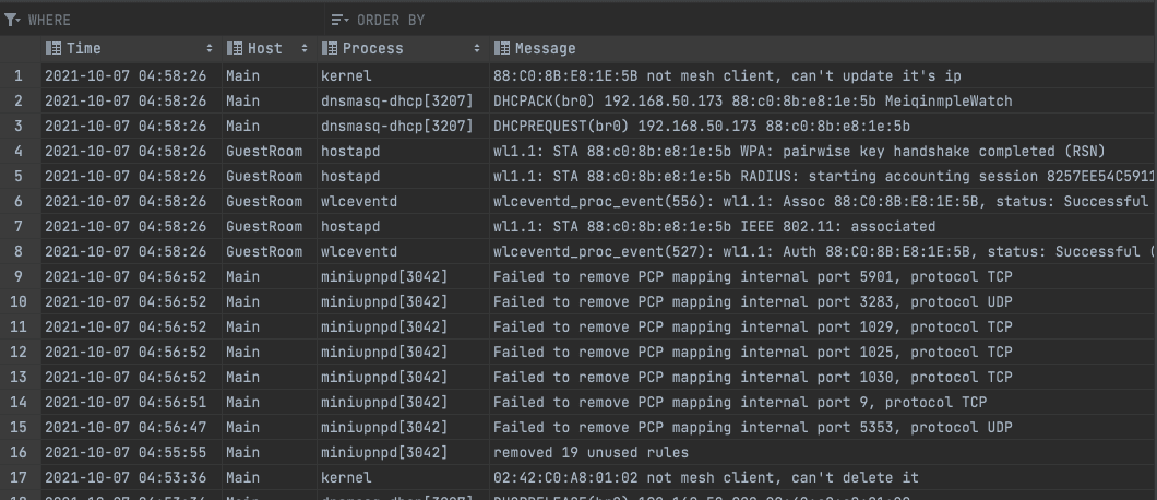

You can create a view in the database to show only the columns of interest:
create definer = `Syslog-Admin`@localhost view conciseevents as
select `syslog`.`systemevents`.`ReceivedAt`                                                                        AS `Time`,
       `syslog`.`systemevents`.`FromHost`                                                                          AS `Host`,
       trim(trailing ':' from `syslog`.`systemevents`.`SysLogTag`)                                                 AS `Process`,
       trim(leading ' ' from `syslog`.`systemevents`.`Message`)                                                    AS `Message`
order by `syslog`.`systemevents`.`ReceivedAt` desc
limit 501;
