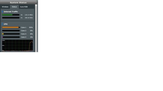

I purchased a brand new gt-ax6000 based on feedback and a lot of in-depth tech reviews. One observation I have is that it seems software and hardware only utilize 1 core to execute QoS related tasks. As a result, Core 1 is always active and spiking to 100% when I do downloads and/or upload at 900+ Mbps. I am running Merlin 388.1. Flash 2 different times and NVRAM cleared. Same behavior with latest stock firmware.
I already disabled the radios so no WiFi, this is only a router device for routing functions. Every time I enable QoS regardless of the option selected, core 1 spikes to 100% and the remaining cores stay at 0-5%.
I am using both 2.5 Gbps ports.
Is this a normal behavior? - I am re-thinking if the router is the correct one for 2 Gbps service with QoS enabled. Thoughts?

Most (possibly all) of the processes on these routers are not multi-threaded, meaning they can only use 1 CPU. I believe they've tried to assign certain processes in the firmware to certain CPUs to try and balance the load, but QOS can only use one core and it is saturating that core.
As others have said, if your internet service is that fast, you don't need QOS, unless you have a slow upload speed, in which case you should be able to just apply an upload limiter. Not positive if you can do that without download also passing through QOS though.

The spiking is with only routing, QoS and NAT enabled. Everything else including WiFi is disabled. I may have to wait for the new router/CPU to see if QoS can be enabled or wish routing can be multi-threaded.
