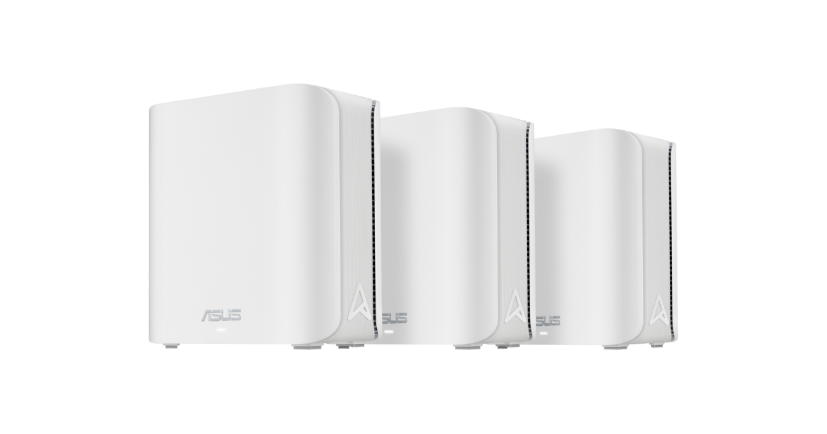

For entire system upgrade this is the cheapest ASUS offer (currently $275 on Amazon):
Not the latest and greatest, just basic AiMesh set with 3x units. It will allow network-wide Guest Network and may bump a little the wireless performance. Being BE-class may get somewhat longer support.
Is there any advantage, other than new, that this system above would get me over my old system that would use the upgraded “be model” mentioned above and using my old rt-ac66 for my APs? I am completely happy with current system. Have never ran into a speed or connectivity issue on my current old setup. Thanks for the input as I really now little about this stuff and just looking for a little advice from some people with better knowledge than myself.
Potential advantages:
- newer devices with expected longer support
- security fixes not only for Internet facing device, but Wi-Fi as well
- single control panel for the entire system
- propagation of Guest Network to nodes, network-wide
- better looking devices for home setup with smaller footprint
- 2.5GbE Ethernet ports
Potential drawbacks:
- the cheapest mesh set is usually not the best, may come with issues
- there is no Tx power control in AiMesh and it may cause "sticky clients"
- additional switch may be needed for wired devices, extra cost
- 2.5GbE Ethernet may require some wires replacement, extra cost
- there is no Tx power control in AiMesh and it may cause "sticky clients”
