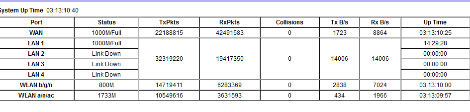

Ok i am still at stock firmware. The last reply from netgear support is they are trying to replicate the issue. if not another remote session will be done. Till then i have to stick to the stock.
For now at time few streaming devices are struggling . But its okay. Not much.
Also i was wondering. How or is it possible to support single MU-MIMO client devices when non-mu-mimo is majority.
As i recently found out that my TV is capable of MU-MIMO AC 2x2 rated connection upto 526mbps.
There is not wall in between just close to straight connection but at 5-8 feet away ,
