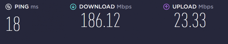

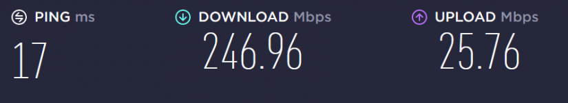

Hello, In the past few days I have tested a number of firmware versions from: 70SF - 83SF, each time I have reset the router to the factory settings and loaded the new firmware, and then back again with the same firmware; the speed test of Ookla every time.
From the SF75, the speed on the 2.4Ghz decreases drastically, like the previous article of this!
It is stable up to SF74.4, then higher is slow and low results.

I do not quite understand. Your last post:
2.4GHz: 186.12Mbps.
5GHz: 246.96
186.12Mbps IMO is pretty good for 2.4GHz... Maybe you have more advanced 2.4SHz client.

Hi Voxel Thanks
I have tree R7800 routers, one Main end two AP
From the 75.1SF the speed is good. When I install a higher version of the SF, the speed drops!, on the 2,4Ghz 40-70Mbs 5Ghz Good!
