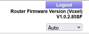

I just signed up for the forum and am a little confused. I've been running dd-wrt but wanted to try Voxel's firmware to see if the wireless was better. I thought I got the newest version V1.02.86SF installed but noticed there was nothing showing (Voxel) on the main screen like I'd seen in pictures so kept thinking I did something wrong.
I reverted to an older version 1.0.1... of the Netgear stock firmware then upgraded to 1.0.2.59S version of Voxel and it did show (Voxel) next to the version on the router screen. Finally I upgraded to the newest version of Voxel, 86SF, again and the name is gone. Did he remove his name next to the Version at some point?
I can verify on V1.0.2.85SF the Voxel name is above the firmware version. Maybe you need to clear the cache on your web browser?
