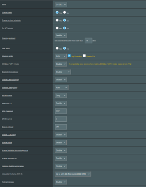

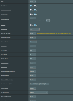

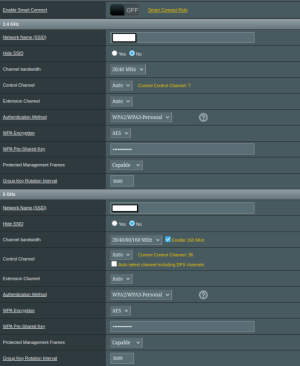

I am on Merlin 3006.102.7.2
As I was looking at the screenshots of my wifi settings - and reading your suggestions... I've made the following changes:
- Turned Off Smart Connect - and named my SSIDs separate for 2.4ghz and 5ghz.. since I have 2 routers (main and mesh AP) - I would see 4 ssids when trying to reconnect... (2 x 2.4ghz and 2 x 5ghz)... so this way I can connect directly to the properly named SSID... I wonder if things were getting 'confused' when it would try to reconnect automatically??
I also disabled 11b mode (both the checkbox to disable 11b and changed 11b mode to disabled.
For now will leave 802.11ax / WiFi 6 mode ON - as I do have some wifi 6 devices...

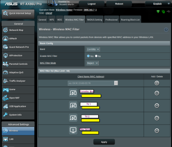

I use MAC filtering to drive my devices to 5ghz... (screenshot attached) (though with separate ssids now - I can shut that off...)
I'll add the update screenshots of my wifi PRO settings...

Turning off the SmartConnect is not going to help. You are best to quit fooling with the WIFI settings so much. Go back to mostly default WIFI but set the 2.4 GHz to 20 MHz and the 5 GHz to 80 MHz with no DFS channels. Use WPA2-Personal. Set the AP up as an AiMesh node and let the clients figure out where they want to connect. The Asus algorithm will try to use the 5 GHz when possible.
If you are having issues with Merlin go back to Asus firmware. It is working very well for me!
