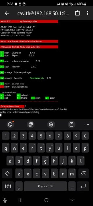

I have been having this issues the last couple of months. Diversion works for a couple of days then stops working. I get a syntax error when i try to go into Diversion (see attached). The only way to get it working again is to uninstall Entware and reinstall. This issues has been frustrating.

The screenshot you provided shows a syntax error ("unterminated quoted string") in the /diversion.conf file at line 44, which is likely causing Diversion to stop working after a few days. This error suggests the configuration file is corrupted, possibly due to an incomplete write. Use SSH to edit /diversion.conf and fix any missing quotes on line 44, such as a string that doesn’t have a closing ".
Post the output of:
grep adsCountLM /opt/share/diversion/.conf/diversion.conf
Something from your dnsmasq.log is likely breaking the variable’s quoting.

Login with SSH and run the command I gave and copy/paste the output here. We don’t know what the problem is yet until we see that first.
adsCountLM='Apr 15 17:20:00 dnsmasq\[19464\]: reply LBP6000_LBP6018%20%40%20Linda's%20iMac._ipp._tcp.local is NXDOMAIN'
This is all that I got from using the above command. it seems to be pointing to a shared printer.
It looks like the apostrophe in Linda's iMac is causing the problem. @thelonelycoder could add another "escape" for the apostrophe in the next Diversion update (if it's that easy to achieve). Perhaps for now, you can edit that file to have the line just read
adsCountLM=''
It looks like the apostrophe in Linda's iMac is causing the problem. @thelonelycoder could add another "escape" for the apostrophe in the next Diversion update. Perhaps for now, you can edit that file to have the line just read
adsCountLM=''

@dave14305 Thank you. That bit of code seems to have resolved my issue. I can access diversion from amtm without the prior error. But did the name of the Mac have anything to do with it? It has has that name forever. The issue with Diversion started a couple of months ago. I have been using Diversion for years as well.
