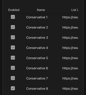

While u know my lists would choke a router easily, I know you use AGH on a separate platform(e.g. rpi). You should give my lists a try. For your AGH, you should be able to use the conservative filter files. I block alot of bad stuff. Check it out. https://github.com/jumpsmm7/GeneratedAdblock
Here is an example of just 1 of them:
It goes 0-14 (Basically 15 different links but numbered 0-14) and is about 4.9 million domains.
This list?
Do you whitelist anything at all? If so can you share your list as well. Thanks!
