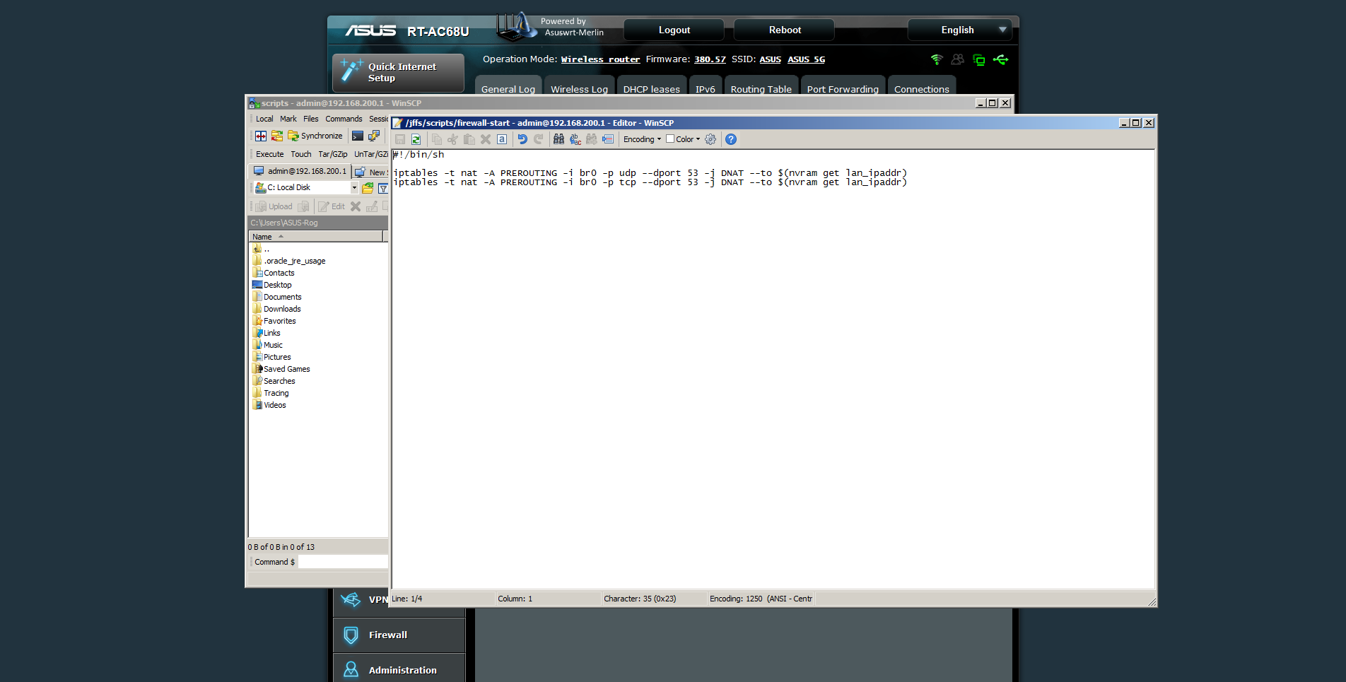

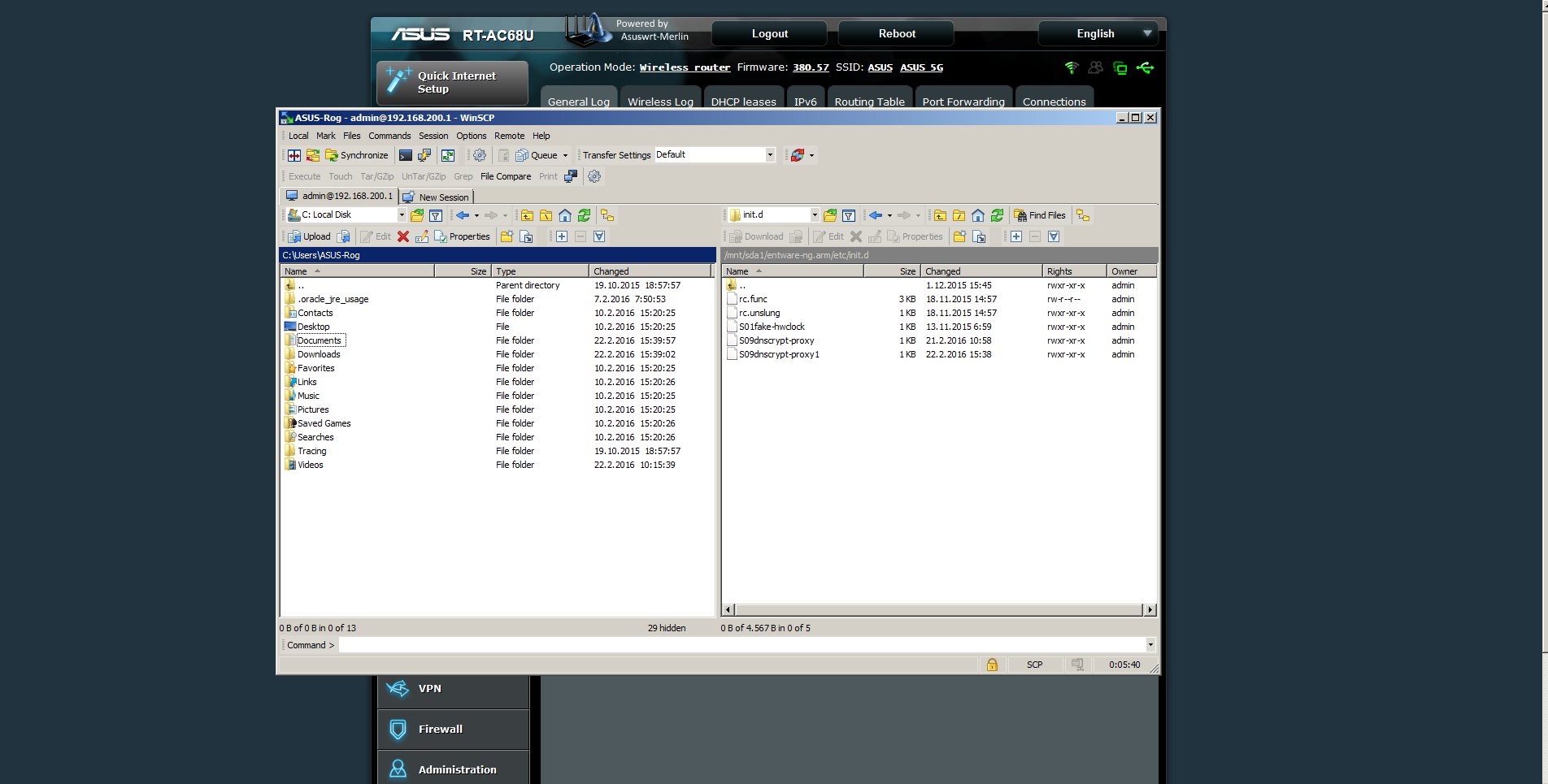

Do you see dnscrypt in your log like this every once in a while? or check if it is running using top?
I have 4 dnscrypt instances running, no leaks here whether using vpn, isp.
So if it is running what is your file /jffs/config/dnsmasq.conf.add say?
Also do you have:
iptables -t nat -A PREROUTING -i br0 -p udp --dport 53 -j DNAT --to $(nvram get lan_ipaddr)
iptables -t nat -A PREROUTING -i br0 -p tcp --dport 53 -j DNAT --to $(nvram get lan_ipaddr)
Somewhere in a script - like /jffs/scripts/firewall-start ? (intercepting dns queries on 53)
Also do you have:

Here is my firewall-start located in /jffs/scripts/
I believe that intercepts dns requests from devices on your network and forces them to use what you specified in a file named dnsmasq.conf.add located in /jffs/configs/
Here is what mine looks like:

Here is the changes I had to make to Entware on sdcard.
Make multiple copies of dnscrypt-proxy in /tmp/mnt/sda1/entware/sbin/
You can try this navigate to the folder and try this-
cp dnscrypt-proxy dnscrypt-proxy1
cp dnscrypt-proxy dnscrypt-proxy2
cp dnscrypt-proxy dnscrypt-proxy3
etc..
navigate to folder#cd /tmp/mnt/sda1/entware/etc/init.d
edit S09dnscrypt-proxy
#vi S09dnscrypt-proxy
here is what mine looks like:
#!/bin/sh
ENABLED=yes
PROCS=dnscrypt-proxy
ARGS="--local-address=127.0.0.1:65053 --daemonize -R ipredator"
PREARGS=""
DESC=
PATH=/opt/sbin:/opt/bin:/opt/usr/bin:/usr/local/sbin:/usr/local/bin:/usr/sbin:/usr/bin:/sbin:/bin
. /opt/etc/init.d/rc.func
Then make 3 more copies of that file and edit them after that.
#cp S09dnscrypt-proxy S09dnscrypt-proxy1
#cp S09dnscrypt-proxy S09dnscrypt-proxy2
#cp S09dnscrypt-proxy S09dnscrypt-proxy3
#vi S09dnscrypt-proxy1
#!/bin/sh
ENABLED=yes
PROCS=dnscrypt-proxy1
ARGS="--local-address=127.0.0.1:65054 --daemonize -R okturtles"
PREARGS=""
DESC=
You can see the pattern, just change PROCS=, port number and name of dnscrypt provider.
Make sure to chmod a+x all your new files created.
Cross your fingers and reboot.
If you can't get back to the internet, try removing those 2 lines in firewall-start, reboot, and set dns to 8.8.8.8 in your computers network interface, just to quick get to internet to troubleshoot.
ok, i done something.....this is what i put in /jffs/config/dnsmasq.conf.add
here is what i put in /jffs/scripts/firewall-start
and here is what i put in /mnt/sda1/entware-ng.arm/etc/init.d
here is fresh syslog after reboot....internet working but i do not know if this all correct or not?:)
http://pastebin.com/0vHQdNbx
