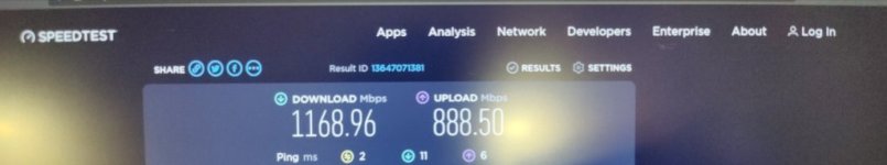

I have attached an screenshot of what I was able to get from WAN and 2.5GBPS but sadly it is very unstable I think this how dual balancing works?

So if I understand what you are saying that it impossible to achieve or make use of the 1 + 1 GBPS that ISP has offer ?
I have no idea what this ISP is offering. You can't bond two 1Gbps connections into one 2Gbps on your side.
seems like it is more Asus is broken over here...
Look here how many Asus routers I have tested. None can do Dual WAN properly, on any firmware. It's just broken for years in Asuswrt. People who say it's working just have never seen proper multi-WAN operation. I have 3 business places with dual ISPs. Cisco RV routers was my previous equipment, Netgate appliances is my current. Asus routers are toys the moment you get outside of common home use tasks. I purchased one AX86U just to see what it has to offer. The same toy like the others, just with AX radio on it. I'm going to donate it like the others and stop wasting my time.

I can say while developing my script, Load Balance Mode when properly working (Using my Script), it will combine the 2 ISPs and achieve total bandwidth. I have a 1Gbps Primary WAN and 100Mbps Backup WAN and when running speed tests I would be achieve 1040-1070Mbps which is about the most I would get with both combined. That was with a 9:1 ratio configured, the problem with Load Balance Mode without my script is the stock firmware doesn't properly apply the fwmark rules in IPTables Mangle Rules so even if the traffic is being marked when egressing out of your network, the ingress traffic is not properly marked because of missing rules so sessions are broken. I resolved this issue with my script.
I have seen an indicated 1.4Gbps from a single WAN Fibre connection too for a few seconds though (fast.com, speedtest.net, etc.). From nominal 1Gbps symmetrical paid-for speeds.
I don't believe those speeds are achievable/sustainable to a single remote server from a single client though. Maybe I'm wrong.
My 1Gbps is physically limited by link speed, by itself I can never get over about 940Mbps (Overhead)...it's definitely combining the 2 in Load Balance Mode.
