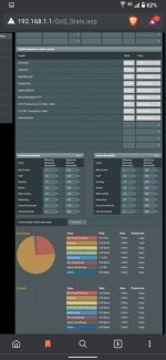

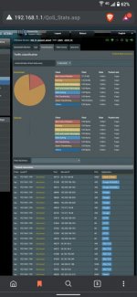

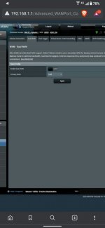

Hi guys , I wanted to know what wan overhead packet I should use in usb mode and nothing is rendered for the upload monitor
thank you
thank you
Dual-WAN USB mode presumably doesn’t use the expected WAN interface for stats to be retrieved by the firmware.

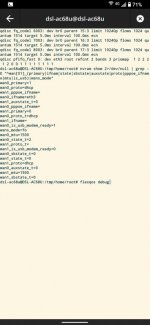

I had a very amazing experience of qos settings in the shooter game, but the problem is that, with zero change, everything is wrong, and I do not understand the problem, in adsl2 +
What is the output of these commands?
tc qdisc
nvram show 2>/dev/null | grep -E "^wan[01]_(primary|ifnam|state|sbstate|auxstate|proto|pppoe_ifname|mtu|is_usb)|wans_mode"
flexqos debug
tc qdisc
flexqos debug

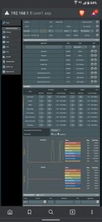

Hi all, hopefully looking for advice how to improve my setup, the two static IP PC's are for me and the wife to connect to work via Cisco Anyconnect VPN, so was hoping all the traffic would go via Work-from-Home category, but seems to go via File Transfers.
She is primarily using web based tools, that does displays a lot of pictures, while I do a lot of work with Office 365/Sharepoint files and both of us use Teams a lot.
This is basically a couple of days worth of traffic.
What do the connections from these 2 IPs look like in the Tracked connections list?
