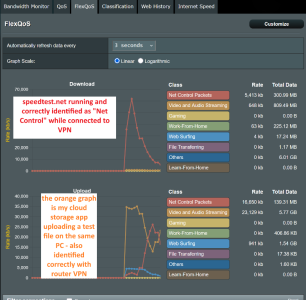

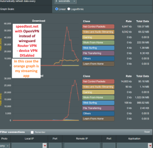

I found out that with a VPN Router config file on my AX88U-Pro AsusWRT-Merlin, FlexQoS is not identifying traffic correctly.
- OpenVPN config Proton VPN file -> all traffic in the FlexQoS graph stays at ~ 0 KB/s.
- WireGuard .conf Proton VPN file -> Download traffic is identified correctly, but Upload is always identified as "Router VPN Outbound Traffic" though the VPN is enabled on the Router and not on the device/computer. (This leads to other devices in my network having slow upload when e.g. my backup server is uploading data at the same time)
- NordVPN Router .ovpn showing no Download traffic and only "Router Outbound" Upload traffic again
I tried this with www.speedtest.net set to "Net Control Packets" in FlexQoS.
Is there any known fix to this so the traffic is identified correctly?
Edit: It seems to be device-related as it is working with my android phone. I will do further testing tomorrow.

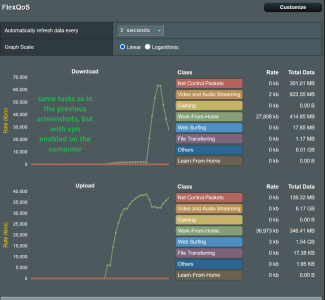

Of course, as soon as I enable VPN on my end device, the traffic is identified as "Router Outbound". But I don't have VPN on my end device enabled in this case.

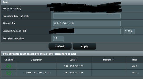

I use Merlins VPN Director with static DHCP IP addresses for my devices. Or what do you mean with IPv4 based VPN? I just downloaded the OpenVPN or Wireguard configuration files and uploaded them into the VPN Client Merlin tab.

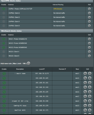

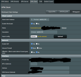

Also show us screenshots of your VPN Director rules, VPN Configuration, and we may be better able to assist.
Thank you very much for your time and assistance!

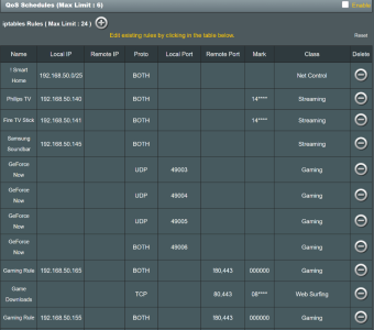

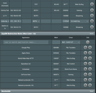

I am referring to running speedtest on my end devices, not on the router interface.

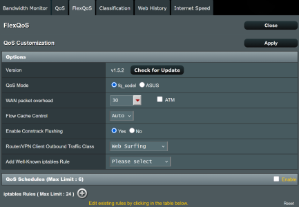

Regarding the current state of my FlexQoS settings - I am still experimenting to properly prioritize all my programs and traffic.
