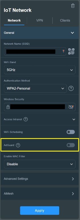

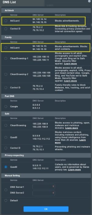

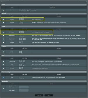

The 3006.102.4 Asus-Merlin on a RT-AX86U Pro has AdGuard DNS server's listed in the WAN DNS Server list. It also lists AdGuard in Guest Network Pro. See attached examples. Or as previously suggested one can install the AdGuard addon script through AMTM.
