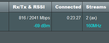

I have this:
Also the channel is 52/160.
This also varies considerably.

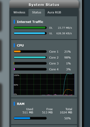

Strange. You could go to the router's Network Map page, select Status in the System Status window and monitor the CPU usage when doing a speed test. Are you hitting a CPU limit maybe?
Certain functions on the router (like OpenVPN) are single threaded. One of your cores is running at 100% so that's probably creating a bottleneck.
To identify the specific process you'd have to SSH into the router and run top.

I think Colin got the problem correct. With the VPN off the speed goes to about ~550mbs and the cores are barely used.
I don't know why I remembered getting bad speed with the VPN off.
I don't think there's any way to get around this to achieve a faster speed with the VPN?
Looks like this is the best I'll have then.
With consumer ruters, yes.
Try WireGuard VPN, might be a bit faster...
