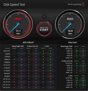

Still, that's only then 26MB/s total throughput which is indicative of USB-2 performance. Surely you have USB-3 abailable on your PC...
Is that solid?
Router? Given the hardware - expected.

I ran multiple test with Plex media server and Apple TV. Smooth play of Dune in 4k (compressed to 1080p) estimated at 38Mbps. Not sure how that is possible though? When the stats are less than 20 Mbps. Definetely happy about this setup and not spending more money on a prober NAS system. This was a cheap solution!
