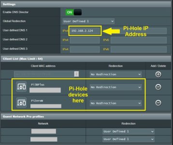

If using the Asus-Merlin 3006 Beta firmware you can set the Guest Network Pro Profile to use the Pi-Hole (for example set in the User Defined DNS 1 field) under the Asus-Merlin DNS Director setting while having Use same subnet as main network set to disabled.
