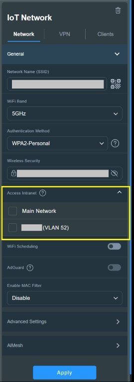

I've checked several times, and I can't see the Access Intranet option with my Customized Guest Network Pro. I wonder if that setting is not available when Use same subnet as main network is enabled, which may reflect Asus' new approach to guest networks after the introduction of VLAN's.
Very possible. Attached is an example of the IoT Guest Network Pro Profile with Access Intranet option. When this profile was initially created Use same subnet as main network was disabled.
