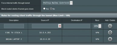

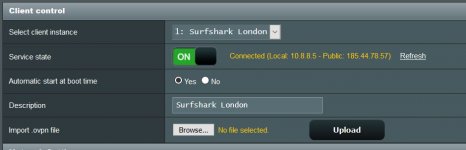

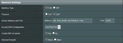

I set up Surfshark VPN on my RT-AX88U as per the uploaded screenshots, but although the policy rule worked for my laptop, my Fire TV kept to using my WAN connection. I tried rebooting it, but no change. Have I missed something?

Looks like it should be working. How have you determined that it's still using the WAN connection?
Unless your fire stick has changed IP...might have to go into the fire stick and manually and set up a static IP
You have rebooted both (router and fire stick)?
as mentioned above, after having checked the IP address is correct, make sure you set the parameter "block routed clients if tunnel goes down" to No .... then you are sure it will never connect via WAN
Thanks Folks. FYI, I had already set up my Fire TV Stick to a static IP address (as most of my regular network devices already are) and rebooted both devices. To check that it was still connected to the WAN, I used the Firefox app to navigate to whatismyipaddressdotcom and this confirmed the static IP address associated with my WAN connection. I may try your suggestion GSpock, but if I do, is there a way to not have that apply to some other devices on the network?

the parameter applies only to the routed clients, i.e. all those IP that you will define in the client section "rules for routing client traffic ..." with VPN as iface.

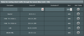

I did set this up again a couple of days ago, but I had another problem with the Fire TV Sticks - when trying to determine my IP address using an Internet browser app, I received an error message about security (sorry, but I cannot remember the actual message). So what I have done now is to start setting up the router so that everything except the Fire TV Sticks, the router itself and devices likely to be taken out of the home use the VPN via the router and the other devices to use the local Surfshark app. I also have the option to set up my local network as "trusted" on the mobile apps, so that the app only applies the VPN when those devices are taken away from home, but I may not need to use that feature.

After further problems* later this morning, I have decided to abandon the idea of putting the VPN on the router.
*I couldn't access my e-mail accounts (using The Bat!) from my other laptop and then Roboform threw up a no access message of some sort (on the laptop that I thought was working OK) and then finally, I couldn't access the router's GUI, so I had to reboot the router from the power switch, uninstall the VPN, dismount the USB drives (just in case) and then reboot the router a second time. I'll just stick with the Surfshark apps on devices where I can use it and not worry about anything else; it's all too much hassle.
