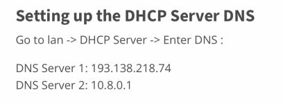

But where would I put the 10.8.0.1? Under DHCP --> DNS? Or as a "push dhcp-option" under custom config? Mullvad lists the 10.8.0.1 as DNS server 2, not 1, so that has me thinking it might not be their primary DNS? See attached photo. I'm just guessing here.
You don't actually push directives from the perspective of the OpenVPN client. Pushing is only required when configuring the server (i.e., the server pushes directives to the client). For the OpenVPN client, you just specify them.
dhcp-option DNS 10.8.0.1
Whether there are one or ten DNS servers available from the OpenVPN provider, it doesn't make any difference which one you use. It's still a DNS server. In fact, I wouldn't be surprised if the two (193.138.218.74 and 10.8.0.1) aren't in fact the same DNS server, and the former is just the public facing IP of the latter. But whether that's true or NOT, as I said, it doesn't matter which DNS server you use. I suggested 10.8.0.1 because if in fact the IP tunnel established is 10.8.0.0/24, the *only* way it could be accessed is over the tunnel. As such, 10.8.0.1 is guaranteed leakproof, and doesn't require a VPN Director rule to bind it to the VPN.
