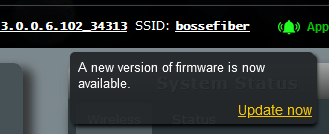

I am being offered to upgrade the firmware as shown here:
Could this improve the situation?
It may do. Wait until the new version of the firmware has positive comments about the features you want in the "ASUSWRT - Official" forum.
Or take one for the other members and update. You can always downgrade back to the version you are using now.
Without knowing what the firmware update version is and what updates or changes have been made in the firmware one cannot say if new firmware would improve the "situation". I would venture to guess no, it wouldn't since the latest 3.0.0.6.102_34314 publicly posted firmware's change log for the RT-AX86U Pro doesn't indicate any changes that may impact Guest Network Pro.
