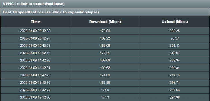

These are some recent speedtest results using the Chicago PIA server.

Ok. Thanks. I’ll add the fast-io, see if there’s any noticeable difference. Closest server to me is Texas but have seem a little difference if I connect thru Denver. Nothing like you posted though.
I’ve been using Speedtest (single connection) to get my results. Are using spdmerlin from the router?
Yes. I get similar results with web based tests also. I would try the multi connection as I seem to remember getting better results.
Then something’s not right with my setup somewhere. Thanks for your replies. I’ll continue looking at my config.
