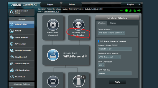

I use a Huawei LTE stick as a backup secondary WAN in case my primary WAN fails.
While the Dual-WAN, failover, and failback functionalities are working well, they are not fast enough.
How can I switch the secondary WAN to Hot-Standby mode?

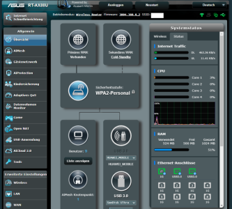

Hi all,
I am running the tests as you described above with a WAN/USB failover/failback setup and when I unplug the ethernet cable it indeed switches to USB after a while. Similarly, when I plug it back it switches back to ethernet after a while (definitely a bit longer than the expected 6 secs). I have NOT tested it with an actual outage that does not involve physically unplugging the cable but I kinda looks stupid to work in one case but not the other. Well done Asus.
Now my concern is that after the (successful) failback the secondary WAN remains in Hot-Standby (as opposed to cold-standby that it was before the switch), keeping the connection open and potentially draining 4G data. I have found no way to enforce cold standby and when I tried a reboot it actually got quite confused for a while until finally settling to the same as below. Any ideas as to why this is happening and I can ensure cold-standby? Any chance it actually reverts to cold standby on its own after a while? Even disabling and reenabling dual wan keeps it at hot standby.

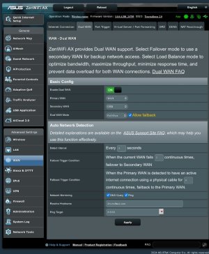

Yes I tried that and it didn’t even switch to secondary :P Nonetheless I hadnt the dns/ping check options enabled
You might want to look into an Addon for a solution:
Guys I stand corrected, after enabling the dns and ping checks it appears to be working flawlessly. Apparently when these checks are off, asus only considers a disconnected cable a failover situation. When on, it worked fine and very quickly when I simulated a no connection situation with the main router and all cables plugged. It also reverted (failback) correctly. I attach a screenshot of my setup, I wonder if my detect interval is too short at 3 secs what issues this might cause in the future.
