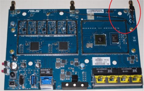

I have a ac68u with antenna mount broken off the board BUT..
tearlach2
The broken one is the one in the red circle connected to the board by a wire into an ipex laptop style connector, the other two are fine and seem to be soldiered directly to traces unlike the one that broke. I can't see any traces going to it on the front or back of the board like the other two, but I don't know how many layers the board is. The wired one which broke was connected to the board by what looked like 4 pins on the back of the connector(antenna mount) that went through the board and stuck out the back a mm or so, and were soldiered, I hope just to mount it. Something hit it and broke all 4 pins off flush. Would I need to try and solder it back on or just glue it in place? It did seem to work ok after it was damaged a year or so ago even though the right antenna was flopping all over the place and I had it leaning against the wall but then I put it away, I opened it up a few days ago to see I might have gotten really lucky with it being the wired one.. would there be some grounding issue?
Your antenna is still working because the thin PCB connected cable you see is coax with ground and active pin. The connector soldering is to keep it in place. It's soldered to the ground layer. You can epoxy it back to the PCB as a quick fix. About extending your coverage - you can use either AiMesh node or AP Mode. It will work the same way for your purposes. Your other AC66R can work in AP Mode as well doing the same thing for you. You can use the same SSIDs in AP Mode and your client device will connect automatically when in range to the garage AP.
