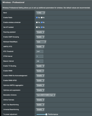

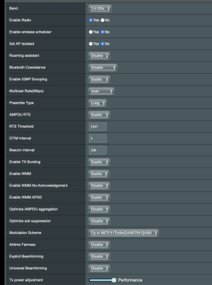

My 5ghz and 2.4ghz settings if it helps. I also did install FlexQoS, maybe that is causing issues somehow?
