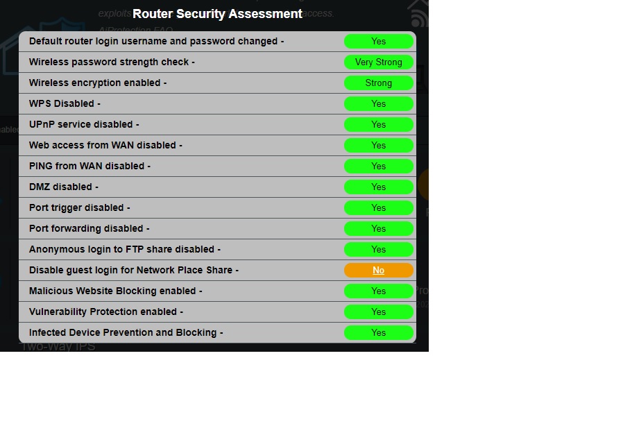

I immediately disconnected the HDD. All my stuff is backed up on another physical drive so I didn't lose anything. I use Bitwarden as a password manager and created a WIFI password that is 20 characters long using letters, numbers and special characters. The router password is different and 16 characters long (max allowed) of letters, numbers and special characters. I did enable AI Cloud and had the AI Cloud app on my phone to access the router remotely. I'm assuming this is how the hacker got in. I did a factory reset on the router and changed password. I did not activate any of the file sharing or remote access. I don't need to access it remotely. I'm wondering what I need to do to make sure it is secure and can only be accessed on my local network? How do you suspect they accessed my HDD? Here is the built in security checkup I did on the router:

It sounds like you enabled AiDisk and then set ftp access to allow anonymous login. That would have given everyone on the internet read/write access to the USB drive.

Click on the one that says “No” & fix it. :p
I do believe that is what happened. I did enable the AiDisk but not sure what I set the ftp to. In my haste I just reset the router to undo anything I enabled so I didn't remember what all was enabled. Judging by the message they left, it sounds like they accessed the HDD and didn't actually access my network? I can confirm now the ftp is not enabled now. I also saw that SSH and WAN are not enabled either.
I did, and when I go to access the HDD in windows explorer, it asks for a password and I enter it and it denies me. It only allows me to access the drive when I allow guest login under the Samba share option. I'm assuming that means anyone connected to my network can access it?
