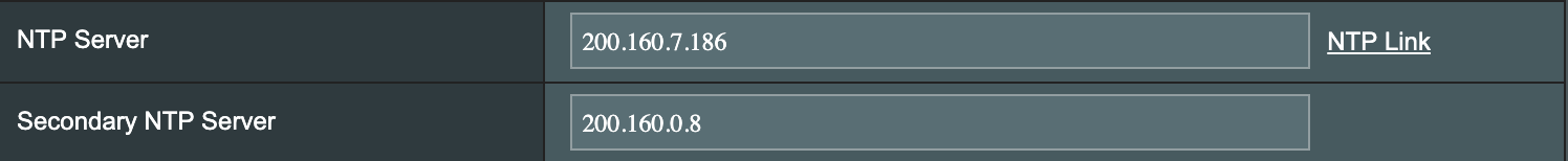

Test add IP number NTP without script wait NTP
The only reason I do not go the route of using a direct IP, for ntp service, is because there may be multiple IP's attached to an ntp server and you would lose out on the benefit of it switching to another IP if the ip you have in its place fails or goes down.
so for short, It may work in the meantime, but in the long run it will not produce a long longevity outcome especially if the ntp server switches the IP's at sync time to reduce the load on the ntp server. it may block you in the long run if your time syncs is constantly hitting the one IP instead of allowing the ip's to be rotated if that is how the NTP server is designed.

i modified the IPV6 part of the ntp server directives to also use ISP's ipv6 if dns servers have not been defined on ipv6 page (meaning it is set to automatic instead of manually defined) for some reason NVRAM variables for predefined and automatic are different when dealing with IPV6.
if [ "$(nvram get dns_local_cache)" = "1" ]; then
     NTPSERVERS=""
     for VAR in 0 1; do
         NTP="$(nvram get "ntp_server$VAR")"
         [ -n "$NTP" ] && NTPSERVERS="$NTPSERVERS/$NTP"
     done
     [ -z "$NTPSERVERS" ] && NTPSERVERS="/pool.ntp.org"
     for DNS in $(nvram get wan_dns); do
         echo "server=$NTPSERVERS/$DNS"
     done
     for DNS in $(nvram get ipv6_get_dns); do
     done
     for VAR in 1 2 3; do
         DNS="$(nvram get "ipv6_dns$VAR")"
         [ -n "$DNS" ] && echo "server=$NTPSERVERS/$DNS"
     done
         echo "server=$NTPSERVERS/127.0.1.1"
   } >> "$1"
fi
