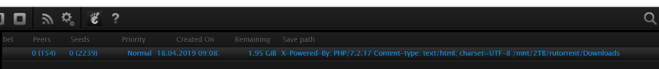

I installed rutorrent on a Asus router and it works fine but if i use the autotools plugin "Path to finished downloads" it move the file in the correct directory but when it does a hash check it say 0% and status is pausing.
This is what it show in the save path from the GUI.
X-Powered-By: PHP/7.2.17Content-type: text/html; charset=UTF-8/mnt/2TB/rutorrent/Downloads
This part "X-Powered-By: PHP/7.2.17Content-type: text/html; charset=UTF-8" should not be their any ideas?
