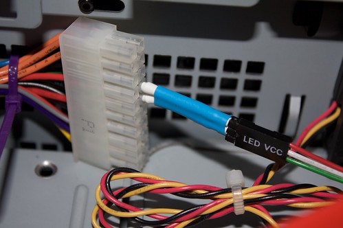

The case that I used, the Chenbro ES30068 (2-bay, cold swap) has a DPST pushbutton switch in back with the three attached wires terminating at a plug labeled "LED VCC." I soldered together the adapter shown in the photo below:
The switch shorts pins 14 and 15 of the ATX power header (nothing new here). While the switch itself looks really wimpy, I confirmed with a DMM that the current passing through the short is ~0.35 mA, so I'm sure the switch will be fine! :p
It's not obvious from the pic, but the red and white wires short when the switch is toggled to the "pushed in" state, and the green and white short when it is toggled off.
Interestingly enough, even with a constant 12V applied at the input, the motherboard powers up and down as expected when the front panel (instantaneous) power button is depressed, or on WOL (to turn on), or when shutdown from the OS. It looks like the ATX12V header and 12V barrel DC input connectors wire into the same pads on the motherboard, so maybe I shouldn't be so surprised.
