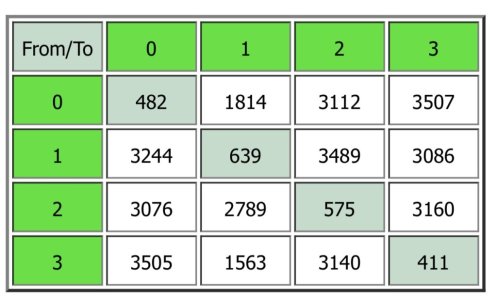

p.s. The PHY rates table shown does seem to indicate an issue with MoCA adapter #1, with the rates in the vertical column associated with adapter 1 all showing well below the preferable 3500-3600 range. Pretty odd for the diagonal “GCD” rates to be so low, as well; these are typical vs Lou in the 600-700 range.
I don't understand the PHY Rates screen I posted. Is the adapter I'm looking at '0' in the diagram? How can I tell which adapters correspond to which numbers on the diagram? I know the IP address of each but the diagram doesn't show them. A link or brief tutorial would be most welcome!

power off all but the 1 pair to figure out which path is the issue. i think the number order is based on sequential power on.
I don’t know. I haven’t seen any page that provides this detail, so the only thing possible might be if mousehover over one of the table indexes offers info … but I doubt it. Just seems an oversight, like not including more details regarding RX/TX power levels for each link.

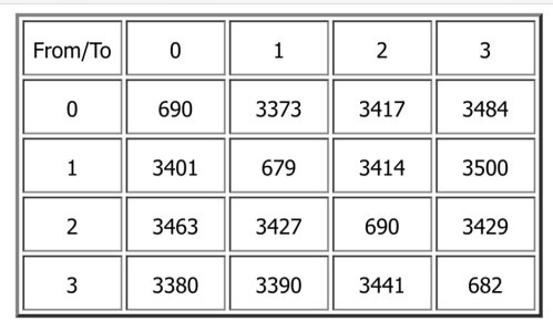

New network diagram pdf attached. Also the phys rates for 1 of the screenbeam MOCA boxes look better. See attached pdf. Previous low phys rates were probably caused by the shorted F-connector.

And, yeah, marked improvement in the PHY rates….
BEFORE
AFTER
