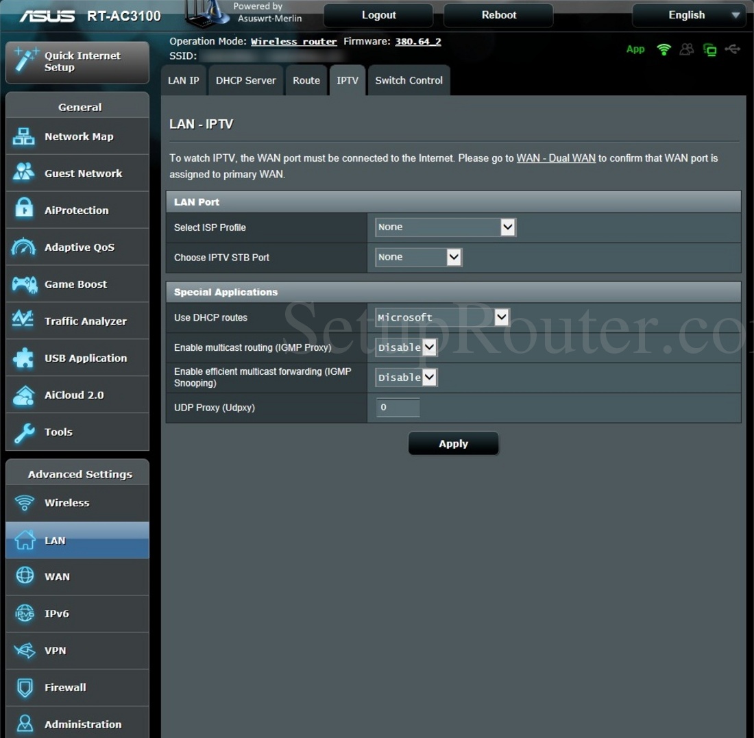

When I had asus router, there was an simple IPTV setting in GUI, which worked well for me, I just had to choose LAN port where IPTV will be connected
Thats how it looked
So basicaly I just need to do this same, but in tomato shibby... Cant it be somehow done with VLANs?
