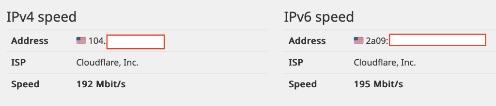

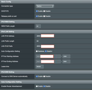

I have Spectrum as my ISP and have been using IPv6 for years. My home network is pretty much an Apple ecosystem and all of their devices use IPv6 as a first choice. It's seamless and unnoticeable when a device switches from IPv6 to IPv4. I'm attaching a snapshot of my ASUS configuration and a IPv4/IPv6 speed test from my NC location to Germany.
For more info on IPv6 go here: IPv6 Info
