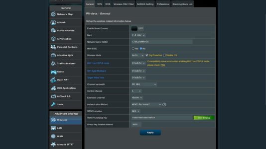

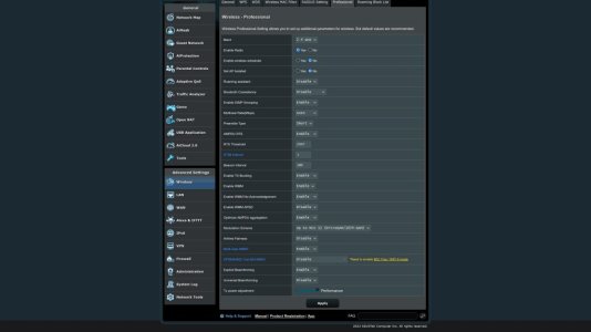

It's the ax-82u, I'm pretty sure I'm outside the warranty period now. Here are my current settings, is there anything I can try?
I have read through this post and have not seen what you are using for WIFI authentication. When I got my first AX router I set it up with WPA2/WPA3-Personal. Also used the Dual Band SmartConnect. I had issues with a couple of my older clients that did not like the WPA2/WPA3-Personal. To work around that I set up a 2.4 GHz guest WIFI for those older clients and it worked! Now I just use WPA2-Personal and all my clients are happy including a couple of G WIFI cams.
WPA-2 Personal is what I've got it set to as well.
I have never used separate SSIDs for 2.4GHz and 5GHz in my house. I have one SSID for LAN and 1 SSID for guest and they both have 2.4GHz and 5GHz. I can't tell you what some of the devices use as I don't care as long as they work, and I don't see any slowdowns. I also use WAP2/WAP3.
