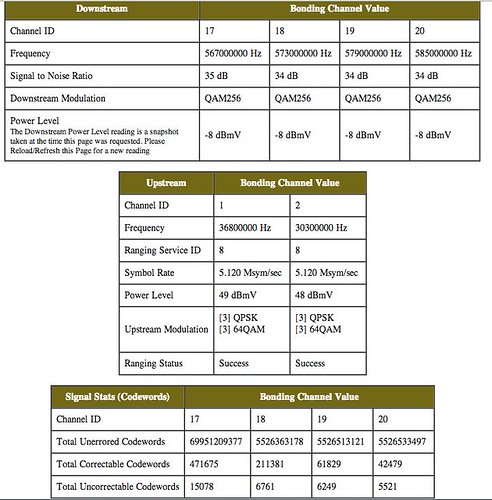

Well I am embarrassed to admit you are right. It is the damn modem! I just realized there's a web interface with logs. And sure enough:
No Ranging Response received - T3 time-out;CM-MAC=7c:bf:b1:61:a5:3b;CMTS-MAC=00:1d:45:6f:d4:4d;CM-QOS=1.1;CM-VER=3.0;
Other people are mentioning this exact same error in the amazon reviews. People using the motorola SB6121, that is the problem! I will be buying a new modem. Thanks for your assistance and patience merlin. You only had to tell me three times.
It could possibly the signal level and I'm going to have a technician come out and look at it. But this seems to be a common issue with this modem.
SB6121 users view your log here: http://192.168.100.1/cmLogs.htm
my 121 modem has been pretty good for nearly 2 years now - I do occasionally see the ranging error message, but its pretty much guaranteed to be Comcast in my case. I dread to think how many repeaters, and splits the cable goes through to get to me here ;-)
FWIW heres my current signal levels (no doubt someone will point out that I'm lucky to be getting a signal at all)
