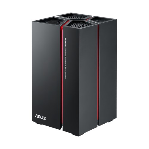

So i bought this repeater or what ever its called "Asus RP-AC68U" and paid 180€ for that, So i tought this will be a very good repeater for me because i have my pc upstairs and fiber downstairs. but the result was that download speed is 30Mbps when im connected with ethernet to the repeater, but if i connect my ethernet cable to my fiber i get the speed what im paying for which is 100Mbps. So i was wondering is this suppost to be this slow when im upstairs or do i have some settings what i should change to get my normal speed ??? Also every few day my pc says that there is no internet connection on the repeater for 30 min , after that its back with a connection. So could somewone help if possible?

Im not sure which one i connected but i am not using wifi with the repeater only ethernet from my pc and the repeater is next to my computer. i bought this repeater because i dont know much about internet things so i just tought that its kinda expensive so it has to be good enough to have good speed upstairs.
The connection between your repeater and your modem-router downstairs is done over Wifi (thats how repeaters work).
You have to setup this when you first time install the repeater to use 2G or 5G Wifi, and 5G would be much faster if signal is strong enough.
So check repeater how you did it and change to 5G if possible.

And this repeater doesnt have external antennas!!!
He wrote he gets much more speed with built in antennas from laptop connected to main-router downstairs than using this repeater which should do it better!
Are you mixing up his RP-AC68U with RT-AC68U?

He said he gets better speed when connected by Ethernet cableto his primary router rather than connecting to his repeater by Ethernet cable.
I agree he doesn't mention having an AC68 so my comments regarding external antennas don't apply.
