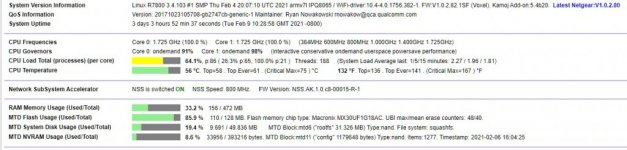

I just looked at System Information (for the 1st time since upgrading to Voxel 82.1 and Kamoj b20 3 days ago), and see that I have excessive CPU total load of 64.1%. I have never seen this number so high. Typically, this number is around 3.1%.
This is a virgin installation; no entware, no VPN, no ad-blocker, nothing. See the attached image.
Suggestions? How can I diagnose which process is causing this?
And I see you use an OLD Voxel release. If you used DNSCrypt that could be the cause.
Be sure to update to latest Voxel.

82.1SF is the newest Voxel (Feb 4, 2021). I don't use DNSCrypt. I have a default installation; absolutely NONE of the special features are enabled.
I don't understand how I am to implement your remark "top2".
UPDATE: A restart appears to have fixed this (CPU total load is now 4.1%), but the question remains as to what could have caused it to spike and stay there.

Why didn't you use top (it's in Kamoj menu -> System information) to see processes CPU and Memory usage.
Sorry for being short!:oops:
Life is not always easy and harmonic, but I want to help as soon as I can.
top2 is router command showing all processes sorted with highest cpu load at top.
Try! And/or follow @sppmaster advice.

After a new install of Firmware there is "al lot of" downloading and installing done by Netgear/Voxel FW.
That causes high load as well. But now you know what to do next time!:)
