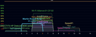

Outside on the terrace I see a lot of networks, see also attached. Maybe this is the reason, why I can't use my wifi on the terrace. But this problem didn't exist with the orbi, because the signal was strong enough.

I don't have a newer Orbi hardware, but play with the channels you use. Don't follow 1-6-11 on 2.4GHz, find the channel with most available bandwidth. For 5GHz use non-DFS 36-48 or 149-161 to avoid radar transmission interruptions. Disable in settings everything you don't need or use.
If you have neighbors with decent WiFi signals parking outside of 1/6/11 can be an annoyance. From experience…
In condominium buildings most routers run on Auto and occupy every single available channel on 2.4GHz spectrum. The neighbors may be very nice people, but don't expect everyone to know how Wi-Fi works. Channel 1-6-11 only when you have control over the APs. When you don't - best available bandwidth channel works best. I can have ~40Mbps on 2.4GHz only on Channel 4 in my downtown apartment, for example.
I dunno, that does not match the advice I've read from people whose competence I trust. That advice says, if you live in an area with lots of 2.4GHz WiFi users:
* Stick to the 1-6-11 channel usage pattern (assuming your neighbors mostly do likewise). If you choose an intermediate channel, you won't magically find some free bandwidth there. Instead, your transmissions now overlap the frequencies of two sets of neighbors not just one set. That means double the opportunity for collisions and forced retransmissions, degrading the WiFi experience for both you and your neighbors.
* Don't use a 40MHz channel. Again, doing so means you're conflicting with twice as many neighbors as otherwise, degrading the experience for everybody.
You can get away with ignoring these guidelines if you have no near WiFi-using neighbors. But if you do, and choose to ignore them anyway, all I can say is I am very glad I am not your neighbor.
One of the things that horrified me (after I knew better) about my Orbis' default setup is that they seemed to ignore both these guidelines. They definitely enabled 40MHz on 2.4GHz by default (and made it pretty obscure how to disable it), and while I don't have them turned on at the moment to check, I think they defaulted to channel 3, meaning that they overlapped all three of the standard channels. I will need a brown paper bag to put over my head if I ever discuss WiFi channel usage with my neighbors.
