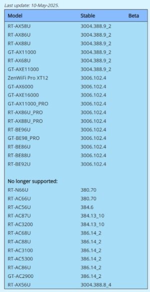

Hello everyone, I am a beginner. My ASUS router RT-AC86U was purchased in 2020. It is an older model. The current firmware version is: 3.0.0.4.384.14_0. Recently, I plan to upgrade merlin to cope with different network needs. Therefore, I would like to ask everyone, what type of firmware version does my router support, and how can I find the right firmware? Thank you very much for helping me!

See the main Asus-Merlin website with lists supported routers and the latest firmware for each of those supported routers.
Note however that the AC series of routers (including the RT-AC86U) are no longer supported by Asus-Merlin due to their age and firmware track. Because of this the last/latest Asus-Merlin firmware for the RT-AC86U is 386.14_2.
Direct release link: https://sourceforge.net/projects/as...-AC86U/Release/RT-AC86U_386.14_2.zip/download
386.14_2 Change Log: https://www.asuswrt-merlin.net/changelog-386
Release announcement and discussion for 386.14_2: https://www.snbforums.com/threads/a...lable-for-ac-models.91060/page-10#post-934246
It is wise to read the entire change log to see if there are any special instructions for firmware installation. It is also wise to read through the release announcement discussion to see if there are any issues or recommendations with that firmware and one's router model.
There may be other third party firmware like Tomato or DDWRT that may have continued support for AC series of routers. One would have to consult with those firmware developers/sites to see if their router is supported and what the latest third party firmware is that supports it.
